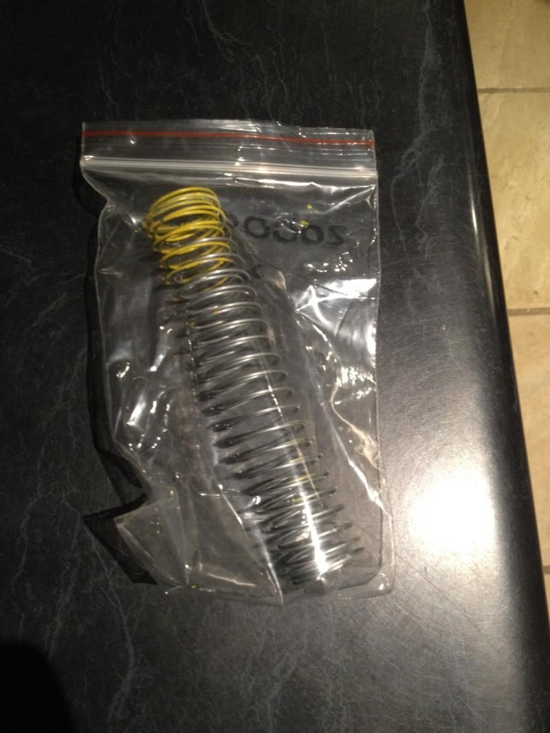

Ok so these finally arrived today. Wet season is upon us and we have a looming low which could turn into a cyclone off the coast. So not sure when I will get a chance to take the car out again.... Also ordered some SU damper Oil. Will give that a shot to. The kind Dr Mini has supplied me with a vac advance unit, also bought a new vac line assy to go from carb to vac advance to. Will just put that on for interest sake, may help cruise mixtures a little?

Got the yellow springs and M needles fitted and some SU damper oil. It's wet here at the moment so can't go for a test drive.

Got up early this morning while it was only 30 degrees, so I could beat the heat... Went for a run with the yellow springs. Cruise is now much leaner, 13:1 still not ideal but I don't have vac advance. WOT through the gears is usually about 12.5-13.5:1.

And your earlier question about leaning out, you're right, it's the dashpot oil. My memory's rough here, but heavier oil means the dashpot rises less quickly against the spring. To avoid the vacuum of the opening throttle from pulling the needle up too quickly and thereby flooding the engine with too much fuel. So, if it's going lean, maybe you need a thinner oil - or no oil - so that the dashpot rises a little faster transitioning from cruise to WOT.
But I think that's a well documented - and tested - story there, Hanra. You've gone from AH2's, Red Springs and Singer Oil in your twin HS2's to M's, Yellow Springs and SU Oil. And you've gone from running lean, breaking down, missing and not revving cleanly to something that sounds pretty happy in your videos. And something that's running some rather nice mixture numbers. Good job. :D
