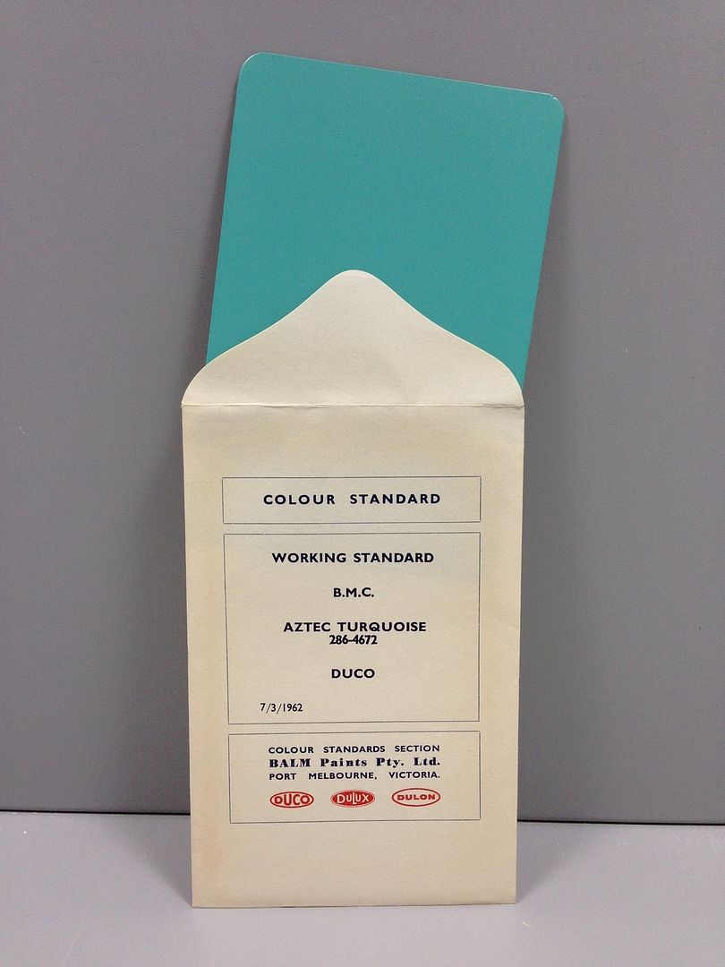

Evan, yes nitro-cellulose, enamel and acrylic are different types of paint. The resins used in each are different.
If I get chance I'll try to find how many of these original colour standards I still have at work.
I didn't get much time at work this week but I did dig out the standard for Aztec

Thanks for sharing the colour standard Lindsay, brillant! I'd be interested in a photo of Orient Red and Inca Yellow if you find them.

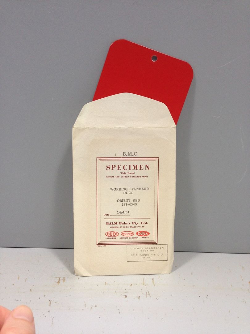

Have not been able to locate the Inca yellow yet but here is the red

Lindsay - can you please explain to a novice the purpose of the data on the envelope and enclosed colour card?
How would someone get the correct colour mixed today using that information?
Is a mixing formula included or is it intended the colour swatch be scanned?
Are all the 1960's and 70's BMC/Leyland Australia colours in the system?

I have a feeling that these were used as a "standard" to match the colour to.
Even mixing with a code would get variations. I assume they painted a sample and compared it to the "standard" using the highly trained Mk1 eyeball and then applying corrections till it matched perfectly.

Yes, it was explained to me (I think I have this right) that even if you mix to a code or even take a scan, the final colour match is often done by eye.
I had someone I know (who is in the auto paint supply business) scan the paint on my car so that later I could get a match for any touchups. He took a scan to start with, but then he showed me his 3 or 4 test swatches/mixes till he got an exact match. I think he then saved this final formula for the particular brand of paint he sells.

I recently found in our archives the original manufacturing standards from when Dulux (or Berger, balm) supplied most auto manufacturers in Australia.
These pictures are of these standards. The standard is the colour sample which would have been used to check each batch of paint before the paint was supplied to the manufacturer, in this case BMC.
We now match these colours on request for customers restoring cars in our current refinish products, usually 2k or basecoat. I think from memory we did the orient red already in basecoat and we have done marine blue and a white. Sorry can't remember which.
The information on the envelope is the manufacturer, colour name (though names can change from model to model) and the full product number. This number is in the following format, first three digits ar the paint type, I.e acrylic, nitrocellulose or enamel, then the rest of the numbers identifies the colour. I would have to look what the first three digits on the red standard are as we don't make the product anymore, it has been replaced by better technology.
We do not currently use spectrophotometers for colour matching, this is done by our colour matchers. I think this is what you are referring to when you say scan the colour?
No formula is included on these colour standards, and the tinkers are different now anyway so they would be of no use.
We have almost all colour standards available, however over the last near 60 years some have gone missing, in this case we have a very large collection of the original colour chips which paint stores used to have and we match these. I have checked the standards against these colour chips and I have found them to be very accurate.
For someone wanting to get accurate colour mixed they would hav to request the colour, either from a repair shop we supply or one of our distributors. For colours we have already matched the formula will be available, if it is waiting to be matched there is up to a four week lead time depending on our workload.
I also posted some information on colour matching here some time back, if you want I can add that to this post but I think I have written too much already. Let me know if you need any further information.

M1100, yes this is correct.

Phill, this is usually how a colour match is done by repairers. How close the scan gets depends on how big the library is in the computer, a small library will sometimes not even get close, a big library with lots of colours similar to the target colour will get something very close or even spot on.

Yes, that's what I meant.
Thanks for all that information, very helpful.

Ah I see, thanks ...so actually the scan finds the closest existing formula in a library of formulas, and then the rest is done by eye if needed.
