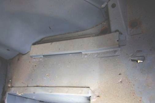

Well, almost 6 years since the last post, time to get it going again. Had the right hand fuel tank out of this vehicle recently for a clean and noticed that the saddle on which it sits is pop riveted in, would this be correct if it was an s body or would it have been factory welded. Also noted that the nut that retains the fuel tank strap bolt located underneath the body is not a captive nut ,ie is not welded to the body, would this nut have been welded in a genuine s body at the factory. Also the left hand tank has a drain fitted at the bottom wheras the right hand tank doesn't., would a genuine s have a right hand tank drain.
The majority of MK1 RH tank support brackets I have photos of are riveted and have an open end.
The majority of MK2 RH tank support brackets I have photos of are spot welded and have an enclosed end and a hole at each end at the top.
Looking at my photos the change over may have occurred in early 1969 in the YKG2S2 5000's.
