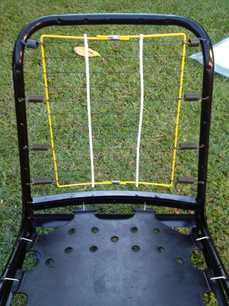

Ok I got my new parts and have fitted the rubber diaphragm and the new spring back. It fits a treat.

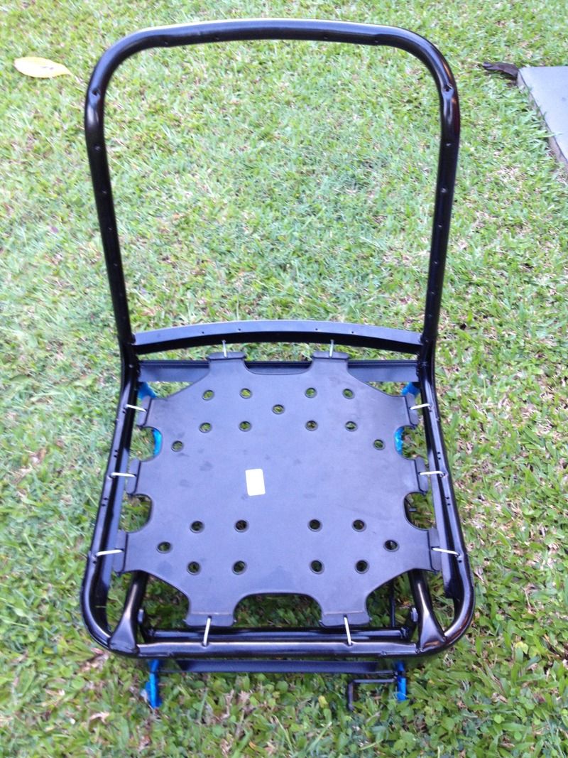

Ok seat parts arrived. Got the rubber bottom diaphragm fitted. Wasn't sure what was top or bottom of the rubber? Which way around should it go? Seemed the way I have it fitted there is a small recess for the shaft of the clip to fit into, like a slot in the rubber. So it seems he most obvious way around?

Looking good :) I think the rubber may go the other way. If you look at my pic the glue from the factory where the foam was glued was on the other side. That said I have no idea if it matters.

Yep I had a good look at your pics and noticed that also. It's just odd that the block of rubber at the ends of the pad have a groove moulded into them that the shaft of the clip fits neatly into?

Perhaps yes your right it goes the other way and the end of the clip once it curls around fits into that groove?

Have a look at the Newton fitting guide http://www.newtoncomm.co.uk/documents/mini-mki-front-seat-fitting/mini-mk.i-front-seat-fitting.pdf

Good stuff mate. I've just finished removing all the clips and flipping it over. Lucky I asked!!!!!

It's a fiddly job. I had to bend the clips a little bit in the vice so they would get on the rubber.
