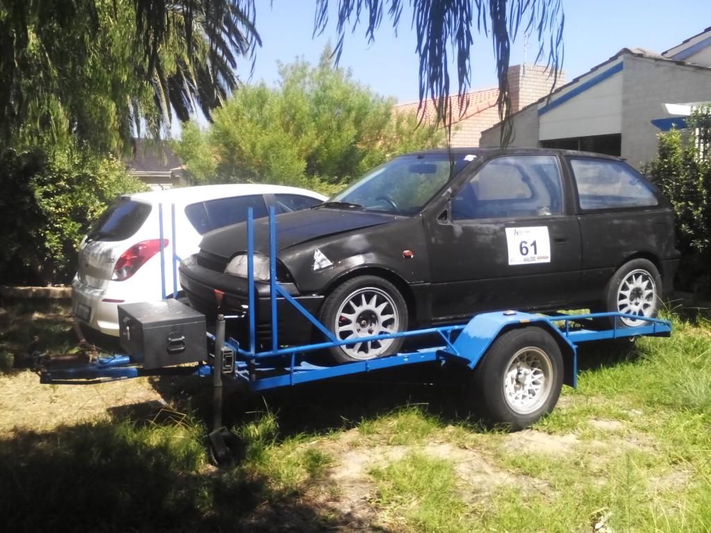

Just remember that the NCOP states that the axle must be no further *forward* than the middle of the load area of the trailer. Mine got knocked back for this last year when I had it inspected to put on WA license (despite it being registered and on the road since 1968), however I took a cue from Ted Curr who had the same issue.
I just added a tool box on the front. This counts as "load area". Trailer passed inspection.
Unfortunately when the Swift is on there it can't go forward enough due to the toolbox!

Just remember that the NCOP states that the axle must be no further back than the middle of the load area of the trailer. Mine got knocked back for this last year when I had it inspected to put on WA license (despite it being registered and on the road since 1968), however I took a cue from Ted Curr who had the same issue.
I just added a tool box on the front. This counts as "load area"....
If the toolbox at the front counts as load area and the axle was not moved then now the axle is further back in the "load area"

AWDmoke - I think you may have said that the wrong way round VSB1 states "Rear overhang (rear loadspace) must not exceed the lesser of 3.7m or the front load space" i.e the axle cant be furher forward than the middle of the load space.

Sorry, fixed!. Axle can't be more than half way way of the load area.
The above trailer is an example of what would not pass, well not without a toolbox on the drawbar!

I would make the wheel tracks 300mm longer and extend them forward over the draw bar triangle so it would be 1300mm and the deck would be 3200mm. Now the axle is 20mm behind half way on the deck.
