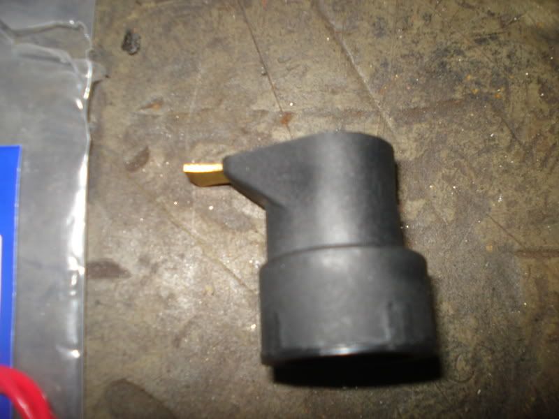

Mick, on this one... :? I've been reading the instructions for fitting the red module (which are on the back of the little box which it came in, which I didn't notice before posting before, though it doesn't mention anything about the silicon paste - anyway!), and they said to do the following:
Simon BBC's packaging instructions wrote:
1. Remove the old Rotor arm and put aside.
6. Fit the NEW black Trigger, ensuring it is aligned witht he top of the spindle lobes and push home fully, being careful not to use too much force.
7. Refit the Rotor arm fully on the shaft with the locating tag, if the cap and clips do not fit correctly - the trigger and/or the rotor arm are not fitted correctly!
Looking at his kit for the 25D (and remember, the Points and Capacitor for the 25D is shared with the 29D, even if the Rotor and the Cap are different), there's no Rotor arm in the kit. :? There is, however, a black ring in there. :o I'm assuming this would be the 'trigger'? So perhaps the kit could work across both distributors..? :?
I don't know whether or not my thoughts on the 25D/29D are correct, as the 45D/43D kit does include a Rotor arm, but it doesn't have a separate trigger. It appears the fitting instructions on the box are generic, to suit all the kits, even though they may actually be a little confusing for some kits (I'm sure someone, somewhere around the world, will be wondering where this 'Trigger' is for their 45D kit!). Food for thought!!!
Still wondering about what to do with this Silicon paste. :wink:
That is the trigger indeed, put it near some iron filings and you will see the filings stick to four magnets recessed in the plastic. The blue kit has a similar ring built integrally with the rotor. The ring does not contact the old points cam however, it hangs like a skirt around the shaft.
Yeah squeeze it (sparingly, less is more) onto the back plate. Clean the backplate to a decent shine before you put the paste on or you are wasting your time. Grime will insulate the plates somewhat.

So... Would it be possible that the module and trigger required for a 25D and a 29D could be identical (given that the points and capacitors are identical), leaving the Rotor arm as a separate component, which allows one kit to serve both types of distributors..? :?

I haven't sat down and measured anything, but all you need to do is have four magnets pass within a millimeter or so of the pickup exactly 90 degrees apart. It's identical operation for each distributor, but the packaging is different. if you could adapt it then it would be the way so go, the unit won't be useless when the rotor button shorts to ground (I've had this happen to me once...waaaay back in 93).

Doc, on the other kits - everything but 45D/43D - they do have the magnet ring separate from the rotor arms. Only on the 45D/43D unit is the rotor arm integrated with the magnet ring - because there's no room under the standard rotor for the magnet thing. :)

the 29d kit has a the magnets set in a collar with a square hole in the center to locate and lock onto the dizzy drive shaft. It will stay there on it's own.
The 25d kit has the magnets as a skirt around the base of the rotor button. The inner edge of the skirt is wider than the square cam on the dizzy drive shaft and if cut off would be useless. It literally hange like a hoop skirt around the dizzy drive shaft.

25d has it integrated...
You can see the little lumps where they lie...
