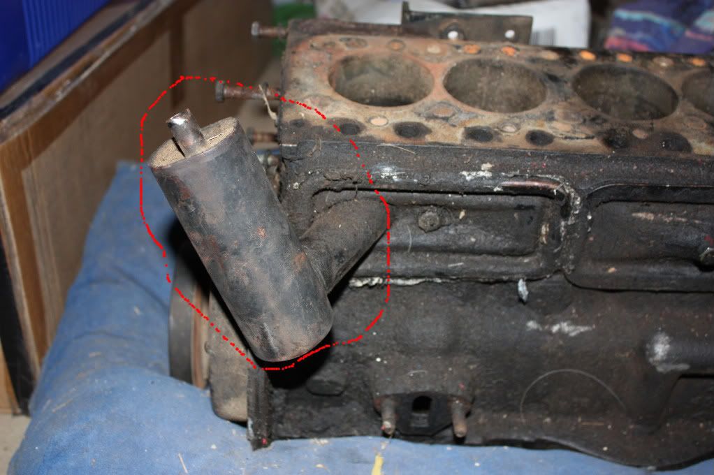

One is a very early Morris 1100 motor and the other is from a later motor with a PCV valve. (1100S, Cooper S, etc)
It cant be that early a M1100 motor as the early ones didnt have a fuel pump hole, like a 998 Cooper block.
Someone has fitted the breather type sideplate, you can see the earlier type plate next to it. I would find a matching later type plate and use them, the rubber seals work better than the earlier cork type.

Hmmm , this seems to be the most confusing of all my previous confusing questions... :? :lol: :lol: :lol:
Well as far as i know, this one is the stock engine from my old 72 clubman. nothing else on the engine seemed to be modified from original, so i wouldn't think someone would have changed that, would they?
And this one is the engine i will be using now.
Quick follow up question, The old 72 clubby engine had that breather and the breather in the rocker cover. but the other engine has no breather in the rocker cover.... is that ok?
Whats the difference?
Does it need the breather ?

The canister breather was used on 998 Clubbies with the 99H engines, from 1975 on. it was connected to the vac port on the SU.
(yes this canister was also on Cooper S).
The correct rocker cover on the 99H engines had a tiny hole in its vent pipe breather to let air IN. If using the SU vac port setup it won't matter if rocker cover is sealed, or not.
You could fit an 1100S/Cooper S oil filler cap which is vented, I do that on the 1360 but use a plain one on the 1412 stroker. It makes no real difference either way, the PCV sytem works fine.
