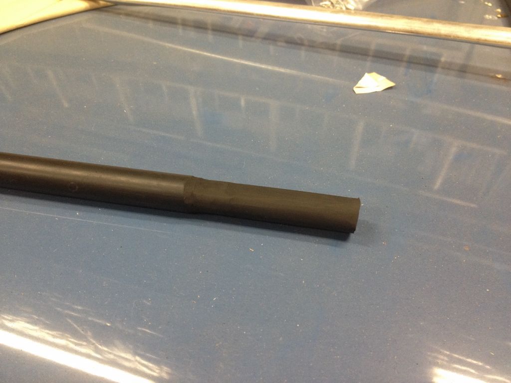

With my large box full of small parts I started putting bits onto the 850 today. I thought I would start with the doors. First parts on are the rubber drain tubes from the window slider area down to the bottom of the doors. I had bought a brand new set from the UK.
They are cut to length and one end is swaged out to a larger diameter so I though they would fit... Wrong... The bottom end is meant to slide inside a steel tube but they are way too large to go in. I had to use the belt sander on them to make them fit.
That wasn't too bad, just dusty and time consuming.
