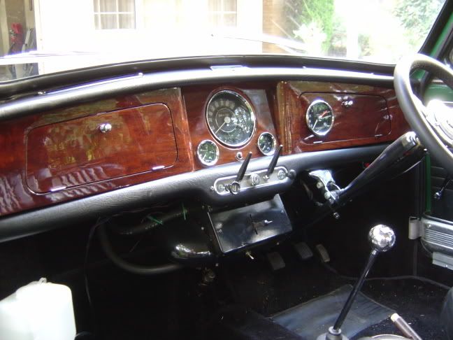

Here is a picture of one.

i luv that dash.
So the heater has controls for demister and floor, as well as a fan, and temp... is that the case?
So If i am looking for that style of heater, what do I need with it? I presume a tap, some conveluted tubing heater itself and an electrical swith for the fan. Do I need any inserts for the demister vents at the top of my dash? From memory my dash (850) does not have anything except the cutouts.
Thanks again for the info

The cylindrical heater reffered to earlier is a Morris Minor unit made by Smiths - it might have been fitted to the 850's but I doubt they'd fit all that well.
The heater with the vertical controls and lettering: "Screen-Car-OFF" is an MK1 Cooper S heater. There is no "gear" to fit in the engine bay so whatever motor you've got is irrelevant. The electric switch is integrated into the body of the heater (its under the panel).
You'll need a sleeve for the fresh air running from the grill through the engine bay and into the firewall (unless you wanna run it as a recirculatory heater) this sleeve is remarkably like the standard sleeves for clothe dryers. And two smalller sleeves and two cooper S or clubman vents (or just use the original metal flap on the driver's side only).

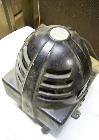

perhaps this is what you mean?
this is an early smiths heater which was an aftermarket job, used on a lot of 1960's cars.
