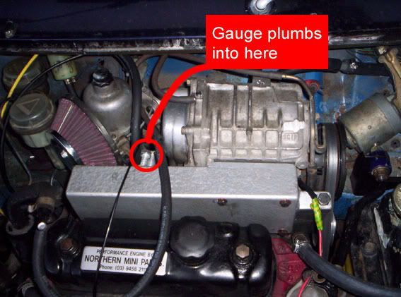

The Gauge is just some cheapo piece of garbage i bought off ebay, T-sport i think it is and yeas in plumbs directly into the inlet manifold, below is a pic (without the gauge installed). The gauge plumbs into where the bolt is you can just see. So it could be a leak maybe?!? Ill have to check all connections!!

PostPosted: Mon Nov 14, 2005 10:19 pm
crappy gauge maybe
is that plumbed into the boxed manifold??? (correct5 spot) or on the carby manifold??? (incorrect spot) ,,,i can`t really see it proply,,,
(i`m too dam old now & need some glasses) :-)

PostPosted: Tue Nov 15, 2005 7:19 am
Posts: 541
Location: Ocean Grove, Vic
yeah its plumbed into the boxed manifold, i checked for leaks, im putting this one down to a crappy gauge!
