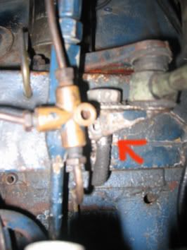

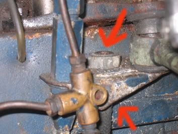

I tried tonight with a pair of cheap multigrips from work and they cant grip the round metal part of the hose. I looked underneath the car and the nut underneath cant move as it sits against a little lip to stop it turning.
is it worth me going out and investing in a good set of multigrips, do you think they will grip better?
Each time i turn the top nut the hose is spinning. The other option i might have to do is remove the brake M/C to get at it from the other side, but i'd prefer not too.
I have thrown some photos in to show the problem.
any advice will be grateful!
shane
you can just see the metal part.

Okay I see you dilemma
Grab an ordinary pair of pliers and simply bend that bit of metal up out of the way. Do it bit by bit so you dont distort the shape. Once its out of the way, you can use what ever multi grips you have to hold the bottom nut. Its part of the hose btw.
On my mini this bit of metal forms part of the bracket that locates the engine steady bar, from the engine, to the body. I am almost sure yours should the same also but maybe others can add a comment.

What about wedging an ezyout/stud extractor into the pipe, locking it enough to get the bolt turning? Failing that, a cutting disk on a dremel and cutting the nut off? I removed the engine steady to make more room.

yep Mike its the same piece the stedier bar goes on. i've lifted that up to gain more access. I tried bending the lip up too, did'nt want to budge.
Anton i might have to change my name from ChopChop to SmashSmash soon the way that little piddly piece of pipe is peeving me off.
Mike will try and bend it up tomorrow again with the pliers. I think a better pair of multigrips should help too.

Why is it bent down like that ??? It should be erect ??? at least paralell to the ground. I have a feeling you have some sort of bodgey engine steady ?? Is that so ??
I have a number and you can have one if yours is bodgey

Mike, Its undone at both ends, i'm going to replace the rubbers while im at it.
Angus dog what is an ezyout/stud extractor, are they easy to get? Would maybe a larger bolt up the pipe tight in there do the trick? Then i can hold the multigrips down lower and get a better grip.

At last i fixed the problem!
I ended up drilling a small hole thru the lip of metal then thru the metal piece on the end of the hose. Then screwed in a metal screw to hold it in place, then undone the top bolt and there you have it. problem solvered.
