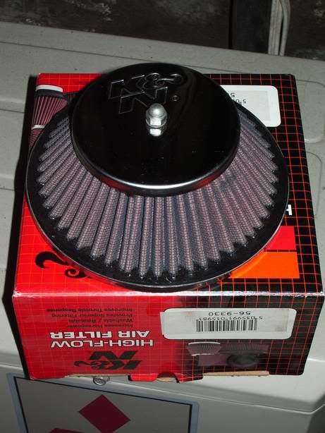

Have you got an air filter for that HIF? I've got a K&N offset cone one if you want it. A few beers and it's yours.
Edit: it looks like this:
