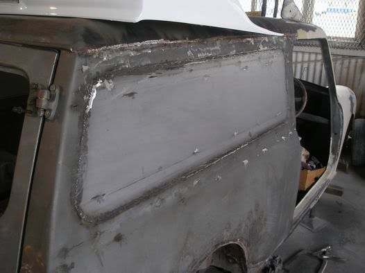

just woundering what u guys might think?
my mini van has the rear window cut outs and personaly i like to solid sides but u see the groovr around the eadge?
well anyways i was thinking of where my cut out is put a sheet of metal and make it perfctly flush so there is no groove do u understand?
please like to know what people think.

Just a thought. While I reckon it would look good, I think the 'outline' adds a bit of strength to the panel to prevent it from going out of shape. I think a flat piece without the reinforement would tend to buckle, and heat distortion from welding the piece in could make it worse.
Then again I could be completely wrong.

There is alot of flex in the panel so it will need to be braced...
The former off set ridge that was there, is there to add strength to the panel. Also the bracing across the roof
adds strength so that is prob a good idea to replace
