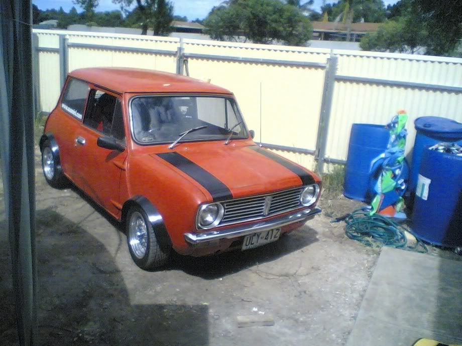

A deseamed clubby:
a non deseamed clubby:

i cant tell the difference
but i understand wat u mean i found this pic 2 --

I'll put my 2 cents worth in , deseamed mini's look good and you can kid yourself that it improves the aerodynamics without too much trouble . Unfortunately , I wouldn't buy a deseamed mini unless I could remove the trim beside the rear window and see behind the other seams to see how it was done . Basically you can grind an inch of seam off at a time and weld the two panel edges together and it will most likely hold till you hit something , depends on how good your welds are as to how big a thing you have to hit for it to fall apart . Or , to do it properly you can weld a strip of metal behind the welded joins as well to tie the whole thing together . As for the panels that you can't get to from behind , best to hammer them a little flatter and weld another strip across them to bridge it as well . The seams we're talking about by the way are the ones that stick out between the front mudguard and in front of the door , the rear side in front of the fuel filler neck and behind the rear side window's , and the roof gutter . As for the one for sale that you want , from memory it's being sold with a month or two's rego left on it , does that mean it can't be registered as is because the job may not be strong enough ? I think it's being sold as a project parts car from memory isn't it (apologies to the seller if it isn't ) .
