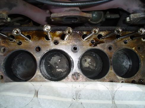

On Saturday I decided to take the head off ZIPI. It had been running ok, the only thing wrong was that after keeping the accelerator down for a while it would idle a little quickly, then if I tapped the accelerator pedal the revs would drop and almost stall.
So I took the Carby and manifold off and gave that a good clean, there was a lot of silt and dirt in and around the components.

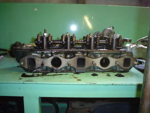

I got a little bit more adventurous (or there was a bad influence there...) and I took the head off. This is the first time that I have taken the head off since I have owned the car for almost 2 years. It is a 12g202 head, supposedly ported and polished (mildly) and this is what it looks like...
The block also doesn't look the best...... Can any one shed some light as to what the build up on the pistons is and if I should look to get some work done.
The bores still look in reasonably good condition.
cheers simon

To me it just looks like a build up of carbon , nothing too drastic . Just give the head a good clean (wire wheel in a drill) around the combustion chambers , trying not to hit the actual face of the head too much , you shouldn't be able to do too much to the face unless you hold the wheel on there for a long time anyway . Don't get too carried away trying to clean the tops of the pistons in case you drop carbon down the sides of the pistons , might hurry the wear on the rings or bore . An easier way to do this is while the motor's still running is to get a fine mist of water from a spray bottle and just spray a little at a time into the carb while it's running , can't remember the chemistry of it all but it clears a lot of the carbon out . As for the earlier bit of the idle being high till you blip the throttle , could be just a bit of wear in the throttle shaft and it sit's on one spot rather than going back to the idle adjuster screw .

Was the head gasket burnt between [EDIT] THE POTS ON THE LEFT [EDIT??....looks to be some burning on the head.

that would be 3 and 4 mick

simon just put a new acl head gasket in there and she will be fine, all looks normal to me :D

I would deck the head while it's off, flatness looks suss between 3 & 4 which is what burned the gasket.
Check the block for flatness too, and make sure it's CLEAN.
Best gasket for these smallbores is the ACL one. :)

I had a quick look last night and the gasket wasn't blown between 3 and 4, however it was fairly black.
What is the best way to check for flatness on the block if it is still in the car?
Also, when I bought the car I was told that the head was ported and polished. Is there any way to check to see by how much or if at all?

Looks all gooders - the misty water thingy while the engine is running gets the carbon off really well. What happens is when the motor ignites, it flash boils the water and breaks the carbon up - look for a puff of soot from the exhaust when you do it. It is adviseable not to put too much water in there(atomiser bottle only - not the garden hose!!)as bent things will ensue.
Looks pretty tidy but as the Dr ordered, flatten it while it is orff and all will be well. Just looking at the back of the head though, look at getting that looked at as well as has the potential for air leaks...
The gasket does not have to be physically blown away to allow gases to be forced between cylinders....thats why the Doc is suggesting you do the decking....

I'd say only get the head shaved to make sure it's flat , don't worry about the bock as it's less likely to be warped than the head , remember , it's only likely that something's warped , not certain at this stage . For some reason though there look's to be a slight problem with the gasket . Shaving the head is a lot easier than pulling the motor out , stripping it and taking the bare block in to be done as well as the head . I may well be argued with over this but that's my opinion .
