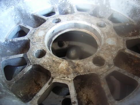

Hey im wanting to make these wheels look like new any tips?
Any direcion would be helpfull..

Have the wheels sandblasted. Then fix any imperfections with JB weld. Then have them powdercoated. Much tougher than paint and you will not be disappointed with the results.
