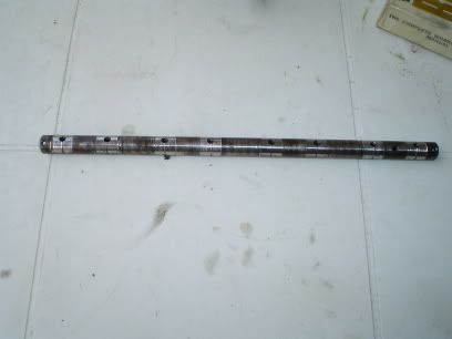

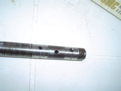

Well I removed my rocker shaft on the weekend and boy was there some wear in it. I had to remove the whole assembly as there wasn't enough adjustment to back them off the push rods far enough.
Here is the worn shaft....

PostPosted: Mon Feb 20, 2006 9:57 am
Posts: 1556
Location: Central Coast, NSW
Cool.. Thanks for the info !
Man, that IS worn !
