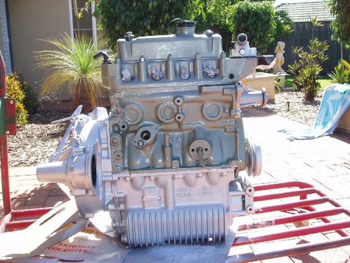

I went to work yesterday to have a fiddle with the mini... I found that there's a buttload of stuff in the way and i can't possibly get a spanner on the nut in question.
I didn't have my camera so i got an old pic of my mini engine and have drawn some arrows on it to confirm what i'm looking at and to explain why i need to go and buy a socket.
Red arrow: Oil cooler hose connecting to the block. This is the first thing that gets in the way of the spanner.
Blue arrow: I guess this is the oil pressure sender for the gauge. This is the second annoying thing.
Green arrow: This is the nut i need to remove???
If i can remove the valve thingo what then? Is there anything i can do to it to fix the problem or will i need to buy something?
- Simon -
