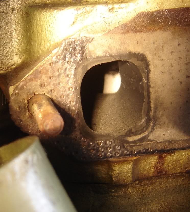

I'm just pulling the 1275 engine out for shits and giggles and it's ten yearly freshen up with some essential maintenance stuff, a new RE13 cam and other goodies and a coat of fresh paint.
I've just noticed that some of the exhaust valve stems within the ports have a whitish ash attached to the top of valve itself, normally I wouldn't hassle over it but since I'm freshening things up....
No.1 and 2 have the white ash, No.3 is as clean as a whistle and no 4 has a brown deposit and a touch of what is obviously wet oil.
is this caused by oil coming down the guides, or from oil getting up past the rings?
Number 1:
Number 2:
Number 3:
Number 4:

The white ash or brown stuff is from fuel additives etc, the oily one I would suspect has a worn valve guide or valve stem.
Unless the combustion chamber of that one has lots of carbon too, I doubt it is rings.
Guides are cheap- I'd replace them all. And any valves that have more than .001" stem wear. Compare to the top bit that doesn't wear. :wink:

I wonder then why number three is so clean??
Must be time for a head off anyway, I sense a pandora's box here...

A water leak into a cylinder will make that one burn clean.. check head gasket.
