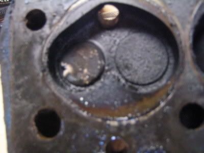

Suspected head gasket was gonna go.
It did.
Today.
On the sydney to coast cruise.
Luckily I made it home.
Got the head off in record time for me, about 10 mins. No more stuffing around with extractors :D.
From what Im looking at I am REALLY consideringa head rebuild and go unleaded at the same time.
From the attached piccy can anyone else tell me their opinion ? Also, 1 out of the
8 pushrods can be pulled from the head from the bottom. ie, the bigger end fits
right through the hole in the head. Is this normal ?

Max - a rebuild would be on the cards and a skim to remove the pitting around the water holes. The valves could be reused and will depend on the faces. While it is orff, why not :D

Yeah....and give the whole cooling system a workover....looks fairly restricted with crud....and whack a bolt in that bypass hose while the heads off... :)

Considering every thing Max the head looks in pretty good shape - bit of a builtup of crud at the front of the head. Your pushrods are jammed because the gunk has hardened around the holes. I have a 12.7mm rifle bore cleaner(round wire brush )that fits in there perfectly(use a 5.56mm one to get around the edges with the rods in place...)

Block looks to be in good nick. In between cylinders 2 and 3 towards back of block, it has a "B" stamped into it. Is this from the factory ? And with this still there, would it mean that block may have never been skimmed in its life ?

looks alot better nick than mine was.....

Again Max the top of the pistons look good too and should clean up ok. Check them by rocking them in the bores - there is a wee bit of movement but if the crown is getting close to the bores, it may be rebuild time.
As the good Dr says, get hold of one of those ACL head gaskets - they really are good.
