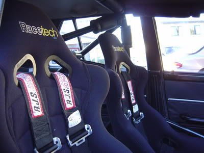

smac wrote:
Surely there must be a way, or has a mini never competed in a Targa in Aussie?!
The way they get around it here is if you have a full cage that's ok as long as you also have harnesses - this keeps you off the cage in a crash. Has to be approved by the motor sport bods and this over-rides the LVV requirements (NZ equivalent of Aussie enginnering cert thingy). Half cage is fine as long as you have high-backed seats and can't hit any of the cage (and no back seat) as described above.
yep, ya have to have an authority card here, this is a pic of the 8point in my starlet, its legal here, but they do get a little edgy over it.
