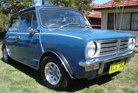

just checked to see what my paint colour is and it says its squadron blue... is this squadron blue... it doesnt really look the same colour as this van http://www.ausmini.com/forums/viewtopic.php?t=19216 or does it? haha
what colour is it?
