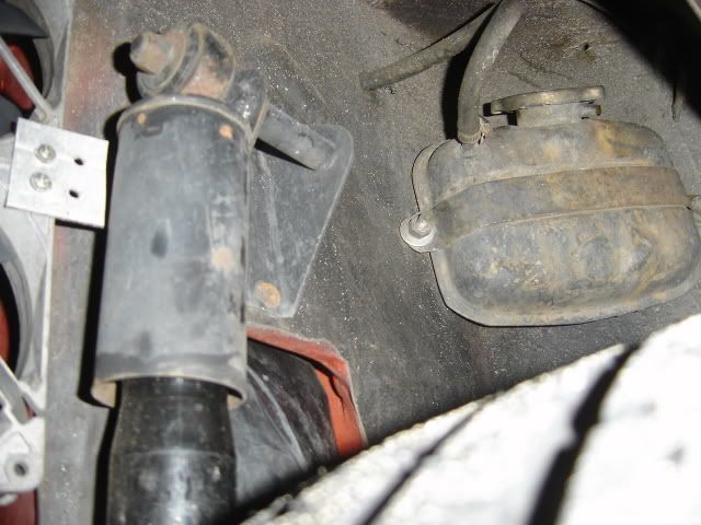

I just bought a moke brass overflow tank, now where is the best place to fit it?
Does it need to be higher/lower than the radiator?
Where is the best place for it to fit?
I tried under the passenger wheelarch (deluxe) but there doesn't seem to be enough room.
Anyone with pics of where they put theres?
Matt
PostPosted: Mon Sep 04, 2006 10:41 am
Posts: 18888
Can't help with a picture right now, but I fitted mine underneath the wheel arch. The bolts come through right up tight in the corner underneath the parcel shelf. Morris even provided a small hole up in the corner near the windscreen wiper motor to put a piece of 1/4 ID hose through to the tank.

Thanks Mick,
I don't suppose you would be able to supply a pic at some stage?
So both bolts came through into the interior of the car? (under the parcel shelf), so it is mounted in the 'rear' of the wheel arch, not on the same face as the shock mount (if fitted)?
Sorry, pics always work better with me than words do :?
Matt
PostPosted: Mon Sep 04, 2006 11:13 am
Posts: 18888
Exactly!
I have the bolt heads snug in the corner under the parcel tray. Works a treat and has seen service for 9 years. I'll see what I can do about a pic this arvo.

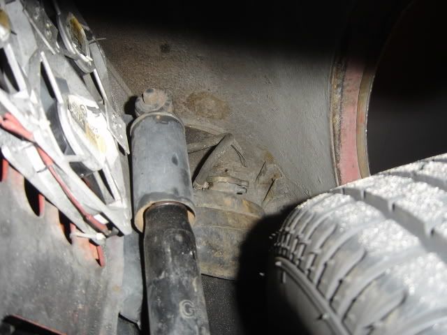

PostPosted: Mon Sep 04, 2006 1:02 pm
Posts: 18888
Should get you through:

How do you top it up? Or am I missing something :? I thought that when fitting one of these you just put a blank cap on the rad and then use the expansion tank to maintain the level.
Rick
PostPosted: Mon Sep 04, 2006 1:08 pm
Posts: 18888
The rad has a blank cap, normal cap on the expansion tank.
Easy to top up, I put a hose behind the wheel and fill it up that way, no need to lift it up or anything.
It'll blow out what it doesn't need and a happy equilibrium is reached by itself. No muss, no fuss and not in the engine bay.
PostPosted: Mon Sep 04, 2006 1:33 pm
Joined: Fri Aug 04, 2006 11:10 am
Posts: 39
Location: Western Australia
Jee Mick that is super cool. I Need less stuff in my engine bay
love the computer fans in the photo too!
are they the ones you were talking about the other day? :wink:
Scotty
PostPosted: Mon Sep 04, 2006 1:46 pm
Posts: 18888
Yeah that's them, bit more than pooter fans though, but they are 4 inch.
Die cast alluminium fans and frames, ball bearing and stall and short circuit protected. They draw 3/4 of an Amp all up. I've had them on 6 years now, I put them on in Darwin and they have replaced the fan.
Cos they are so quiet, I just have them run all the time. Seems to be better as the cooling system isn't playing catch up all the time.

PostPosted: Mon Sep 04, 2006 2:56 pm
Posts: 2213
Location: Darling Downs QLD
Mick,
Those pics are exactly what I needed! Many Thanks!
