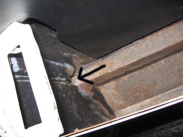

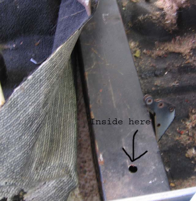

Another question here regarding hard-to-reach surface rust on a Mini. I'm currently in the process of bringing my shell back to bare metal, but I realize that there are a lot of spots that cannot be accessed.
The two examples that I would like to present would be surface rust on the inside of the lower door sill or even surface rust that may be present on the inside of the floorpan crossmember that's under the front seats.
My question is, short of doing a chemical dip and derusting solution, is there anything else I can do to either retard or mitigate this surface rust that's inaccesible (anything short of the obvious brute force solution which would be to cut up the body to access that area)? Another question would be, is it even important to worry about slight surface rust in these areas?

Personally I'd say ignore them for the present but if you're putting it on a rotisserie spray as much rust proofing stuff into them as you can and leave it sit for half an hour , turn 90 degrees , sit for half an hour , turn 90 degrees etc to get a good coating . Not sure what people reccomend at present but avoid fish oil , even the non smelling stuff stinks if it's inside the cabin .

insaide the cross member there isnt to much you can do about that one... Just get some sort of rust killer and try and spray it in there then let it dry and cavity wax the poo out of it... In the door get it sandblasted... Dont want it coming back now do we?? Best to do it right the first time

A good rust converter would be my choice. There's several good brands out there which convert rust to into a hard black plastic-looking coating (Dad said it contains phosphoric acid or something). I painted some on the suspension turret in our Galant which had flaky rust - that was three years ago, and it's still great. It was a stop-gap measure, but it's lasted so well I think I'll leave it until I need to do something else to it (i.e. when it's more convenient).
You can then let it flow into those gaps and it should be sweet - get a recommendation from a good body shop supplier.

Wurth make an excellent body wax. You can spray it into any concealed areas such as the seat box section using a body wax spray gun and tube with a spray nozzle. Quite runny when first sprayed , then hardens to leave an impervious wax coating that protects from further moisture feeding rust areas. Great for protecting inside sills etc.
