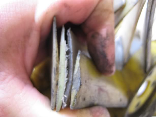

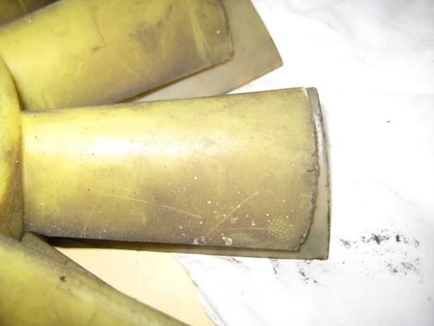

I used to think all plastic fans were the same but have found they vary in blade chord length. Here is a selection that I seem to have accumulated:
Blades have different chords but length is the same until they rub on the rad cowl:
And a close-up showing how much they vary. Quite a big range! I have no idea of what the difference in airflow or noise there is between them and I never learnt that part of aerodynamic theory when at uni (would have forgotten it now anyway).
Maybe someone can shed light on the sources of different fans and how they perform?
M
PostPosted: Thu Feb 17, 2011 6:45 am
Posts: 3135
M
The wider chords were probably introduced simply because they would flex a lot less. As the engines got bigger and more powerful, the parasitic drag was less of a concern and the wider ones would move more air.
The reasoning sounds pretty good in my head anyway :roll:
