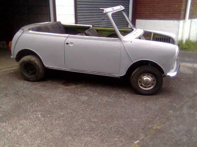

dont even ask about the legal side of things, but this has has $2500Nz spent on streingthening. if its not strong enough, ill have to weld the doors shut. not quite a speedster as it has 4 seats and isint filled in at the back.

Posts: 5717
$2500NZ is about the right price for that kinda job. (not including engineering costs)
I had copies of a few UK conversion plans (Lamm, SportsReplicas, and some others).... they put back so much steel in the strengthening that it makes the car weigh the same as a sedan again (if not slightly more)
Did you get any kind of bracing fabricated into the window upright????
Looks similar in places to the way my roadster project was heading...

PostPosted: Tue Oct 24, 2006 4:38 am
Posts: 1943
sc850 it will indeed be very similar to your plans, previous owners $$$ :D nothing in the pillares YET, but there will need to be some extra streingth there, although saying that, its very very stiff at the moment, ill probably brace the b-pillars backwards, and replace the inside panels below the rear windows with thick plate, and plate the parcel shelf as it needs to extend to the outer panels.
