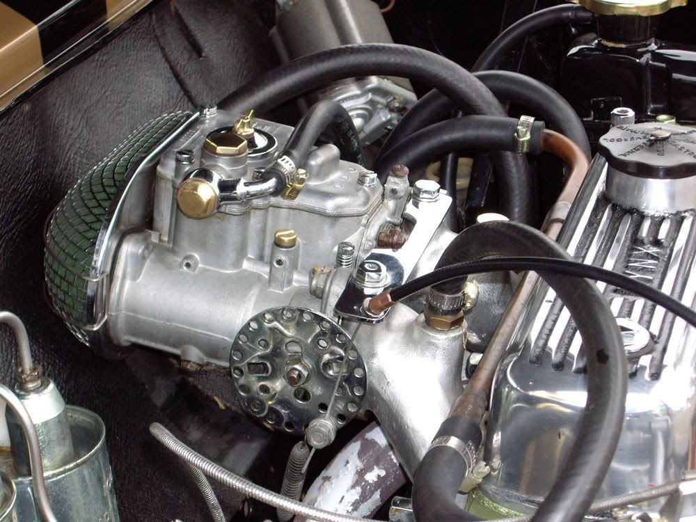

Where does the hose that is coming out of the weber manifold that connects to the brown pipe that runs behind the rocker cover go and what's it for?
PostPosted: Tue Oct 24, 2006 9:56 pm
Posts: 11264
Heater. Doesn't go into the carb/manifold.
Edit... and they are 2 different hoses. The one you can see that goes into the manifold would go to a booster or possibly a PCV valve.

the one on the drivers side of the mani would go to a brake booster
and the cooper pipe next to the rocker cover will atach to the top of the head and then to the heater
yes looking closer there are two hoses :oops:

the bottom radiator hose has an extra branch that comes off it.
that branch goes to the copper pipe
the copper pipe goes to the other side towards the heater.
there is supposed to be a heater which then goes to the drivers side of the head

Connented to the Copper (Brown) pipe is the heater hose
I do Question the hose thats furthest back :!:
