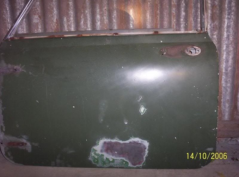

I used a supercheap $15 sandblaster to do a bit of a test on one of the doors:
Took a few minutes to do this much. I think that the bicarb of soda is a bit too light compared to normal media that you would blast with. I seem to get a lot of dust happening with not the same amount of paint being removed comparatively. Although it is quite cheap and you can leave it on the grass and it won't kill anything (the neighbours may start wondering if you are cutting cocaine in your backyard though...)

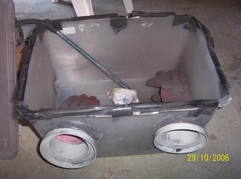

Also made a home made sandblasting unit or more so "box", mainly because I was too cheap to buy a ready made one as I wasn't sure if my compressors were up to it.
Made it from a see through craft box (with wheels!!) and some pvc plumbing pipe from bunnings with some red rubber coated gloves. All up it might have costed about $15....
It does leek a bit of media though so have had to make a bit of a cheap seal with insulation tape and paper. Also one thing to be carefull of is cutting into the box as it breaks and cracks very easily - duct tape works well to fix that problem though :wink:
I found the Norton branded media you can buy in buckets from supercheap better than the soda here as the soda wasn't as abrasive.

What pressure did you use?
I like the cabinet! :D

I made a similar cabinet, only with $10 leather welding gloves.
Never worked that well though.

Funny, that's exactly the sort of thing I've been thinking of making.
Incidentally, I bought some of the sandblast media from Supercheap, which works very well but is (a) expensive and (b) very dense, so it's hard to sweep away (hence the idea bout building a cabinet).
I'm going to hunt for a big, big box, or possibly build one from MDF. There's a kitset cabinet that was tested in Practical Classics magazine which rated well, but too big for my garage.
