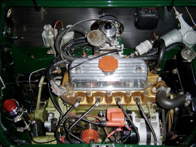

Here is my setup on the 1360, for road use- it works well, no problems.
For track days I remove the PCV, plug the manifold connector, and run 2 hoses into a catch tank. The 2nd one comes off that brass fitting on the rocker cover. I find it adequate, the bottle gets practically nothing in it at the end of day.
The 1L `catch tank' has 2 vent holes 7/8" dia.

Yes you can go from the side cover breather (if S block) into the inlet manifold, just tee in where the booster is. But you WILL need a PCV on there. Too much vacuum otherwise.
The Smiths PCV valve modulates the breather restriction depending on the amount of manifold vacuum. Not all those from other cars do this.
<edit> The breather shown in my pic is an S one, modified to fit on the flywheel housing breather flange.
<edit 2> if by `block side plate' you mean the oil pump flange, I had trouble running mine from there. Crank chucked too much oil at it, the PCV sucked it all up over 4500...:(
Might work, if you baffle it. The gauze inside the breather won't stop this.

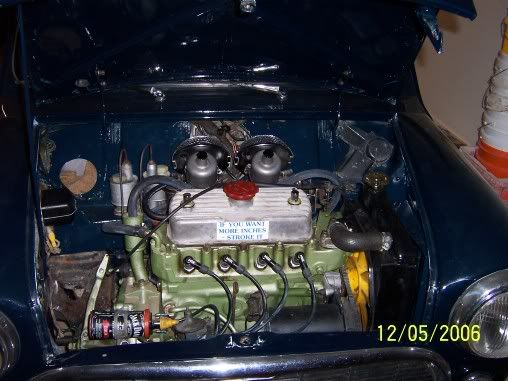

If running 1 SU, just use the breather on the side of the carb, it's a vac port. This is an old pic, I now run it to the vac ports of both carbs.

Yeah same set up as mine cept I run it of the tappet chest cover breather instead. I find that idle is nice and stable

I run two, one to each carb
