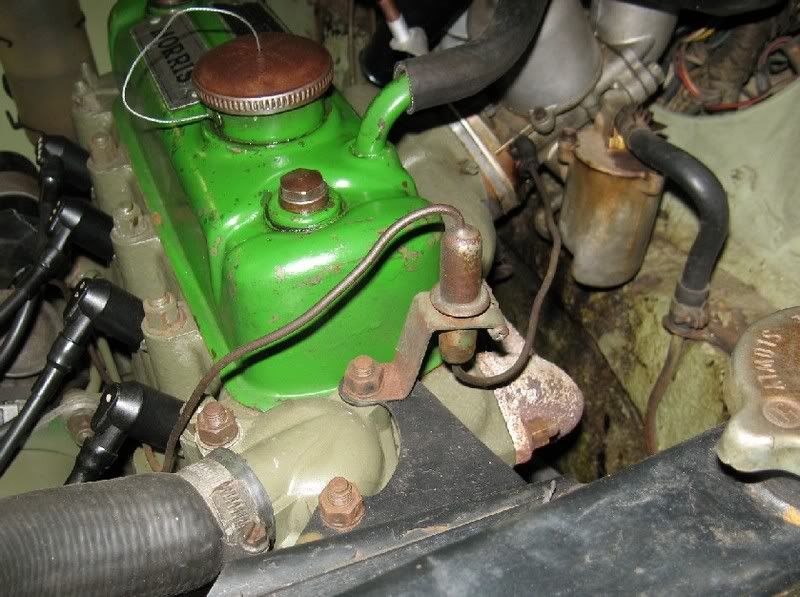

Heres a pic of the bulb thingo on one of our 850's:
It connects to the dizzy via the metal pipe
Here's the connection on a 997 cooper dizzy! :P
Graham 8)
