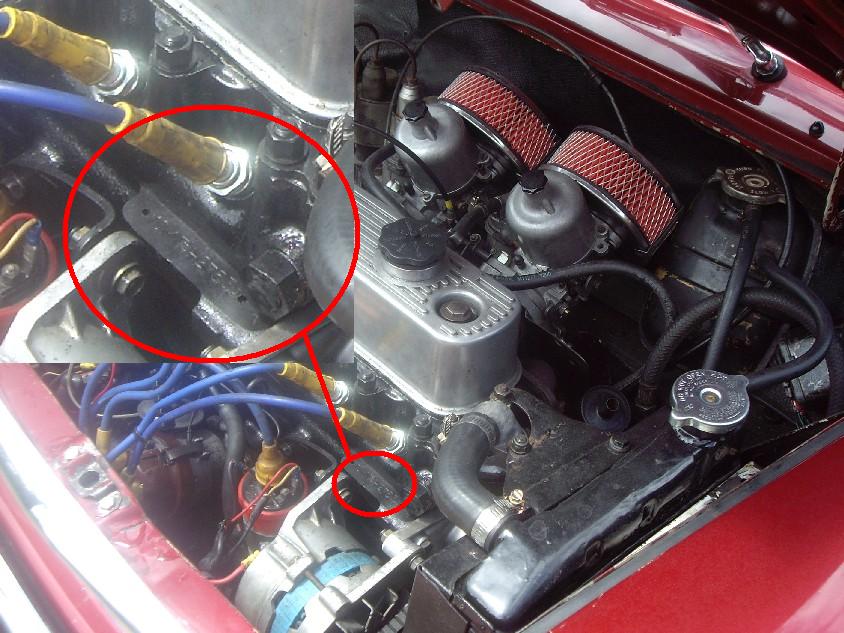

I seem to be having diificulties in finding the engine no. on my LS1275. Where is it located?
Yours embarassed!
Rob
PostPosted: Mon Nov 06, 2006 4:43 pm
Posts: 4031
Below the head, on the block at the front, on the radiator side, on a flat bit of metal that sticks out from the block. Some engines have number ground off for various reasons. Someone post a pic, I would be I gotta go eat some dinner!

PostPosted: Mon Nov 06, 2006 5:18 pm
Posts: 501
Location: Nthside Brisbane
1992 Toyota Starlet GT EP82
PostPosted: Mon Nov 06, 2006 5:23 pm
Joined: Mon Nov 06, 2006 10:45 am
Posts: 193
Location: Canberra
Yep - found it - many thanks.
86310P - A lot of oil and grime on it plus it is not stamped deep into the metal.
For a LS1275 does this fit the bill? I would really like to know whether it is an original or not knowing the history of my car.
Cheers and thanks for the photo. Really appreciated!
Rob.
PostPosted: Mon Nov 06, 2006 6:24 pm
86310P would be a "police" number. That is the number that is stamped onto a motor that has lost its number. :cry:
The 86 on the start of the number is the year it was stamped.
The P on the end means Police. (they approve the change of number)
It should have a letter on front of the number (N for NSW, V for Victoria, etc.)
