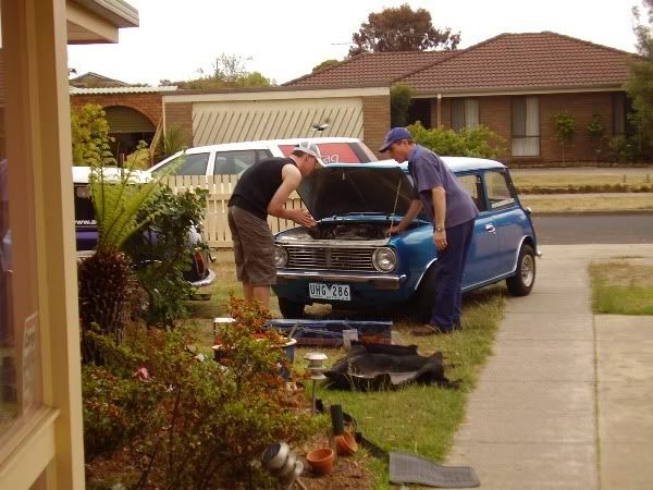

Well anywayrodney was the first to show up.

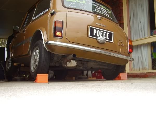

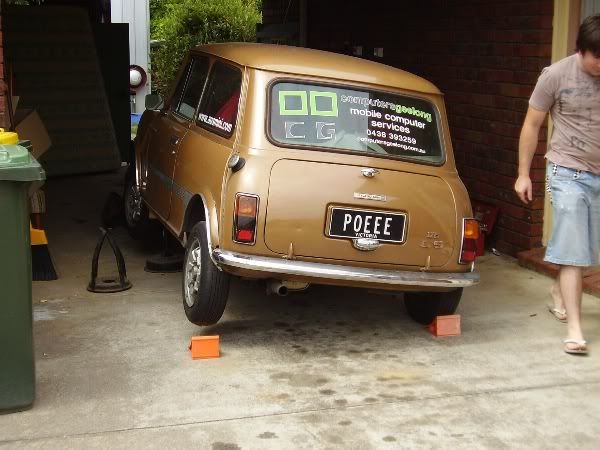

HIm and scott started working on scotts car, trying to get the stands underneath it. This resulted in it doing a facinating balancing act.
THen Dylan showed up.
NOt counting rust, his car has 6 different colours on it!
Fianally JAckson showed up. I dont know if he's been to bed yet, but meh.
Rodney and Jackson start working on his car. It needs the head Gasket replaced or something.

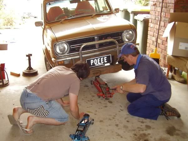

a snippet of the conversation between Rod and Scott:
s: it doesnt fit
r: it came out of there it should go back in
s: thats it give me a hammer
R: no!
from the scene, (ext, day) scott trying to get the new steering rack in.
