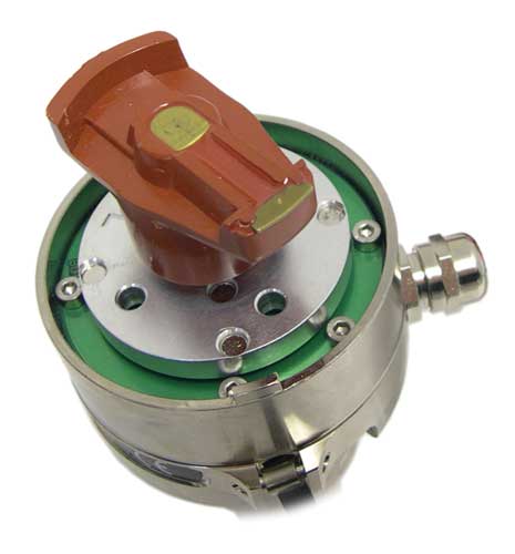

Has anybody fitted a mini123 electronic ignition and if so how do they find it?
Bruizers distributor is dead and the one I have replaced it with has done many amazing things to performance and cooling so I'm looking at the mini 123 with 16 dial in advance settings to get the best from him.
I would like to hear from people using this type not any other.
Steve :D

I'd be keen if somebody could elaborate on what the problem is. Most people keen to 'get the most' out of an ignition system are interested mainly in performance - and for this I'd argue max advance and when it gets there is you're most important factor. From memory this has something like 4 different curves for each of 4 total advance figures? I'd put money on the fact one of those will get you so close you couldn't tell the difference :roll:
Also, kinda' weird people talk about getting performance gains from their ignition - the most a perfect system can do is allow your set-up to reach it's potential - it can't magically add HP!

PostPosted: Fri Nov 24, 2006 9:43 am
Posts: 742
Location: Bexley
I'm looking at it Vs regraphing a ditributor for the engine spec.
The distributor in Bruizer was cactus and replacing it with a working stock 1100S distributor has done unbelievable things to performance but it still isn't graphed for the motor.
123mini has sixteen advance curves and will find the closest to suit the spec of the motor. I don't want it to improve performance just deliver what the motor is designed to deliver.
Pick up a copy of mini world and look at mini sport add which has motors for sale on it
1410cc "drivability with longevity" 95hp, (everyday car 100 000 miles plus motor)
1430cc "road/ track" 135hp, (young kids to much money little sense 50 000 mile motor)
1430cc "lively spirited performance" 112hp (Not an everyday car weekend fun 60-100 00 mile)
A 123mini distributor would suit all of these being as close as possible otherwise you would have to have a 1275 one graphed for each one.
I'll get back on what regraphing will cost but 123 mini would be similar with greater range of uses if needed.

czerial wrote:
I spoke to Graham Russell about these steve, he still thinks the best thing for a mini is the lucas dizzy points set up, there are some other good things out there but he didnt seem to be thrilled with the 123. have a chat to him and see what he thinks, he said its a great thing if ur motor is stock, or factory spec but i know bruiser is a worked one and perhaps this may not be so suitable for him....a more technical explanation is available from him. but yeah, just get ur lucas dizzy recod. willy was there and prolly abosorbed some info also to add to this
I had a chat to GR about these before I purchased mine. He had heard of them, but never used them and didn't know what the advance curves actually were! He told me that he doesn't trust them, because if the electronics fail in a few years, what do you do then. He said that with a points dizzy, carry a few spares (points, condenser, rotor, cap) and if it stops in the middle of nowhere a few minutes later you're on your way again.
So I believe he didn't have any opinion of the performance effects either way.
In regards to performance, the 123 ignition dizzy will let you closely match the ideal curve for your particular engine. With so many variables in engine specification, you may not get the BEST curve, but you will be sure to get far better than lord lucas specified, (you can choose the Cooper S curve, even though it is stated it has always been wrong for the cooper S engine) and MUCH better than an unmodified pulsar curve.
The best ignition curve will always be able to be obtained from a fully programmable electronic ignition set up, which this isn't. But being able to choose from 16 different curves is a bloody good sart without having to mess with modifying the advance stops, and fiddling with springs.
Plus you never have to worry about points again!!
I have the 123 dizzy, and for the small amount I have used the car, it is bloody marvellous! (vibration issues, not dizzy issues, prevent me from using it further ATM)
Highly recommended for anyone who wants to upgrade their dizzy, recieve an easy tuning method with some performance benefit and well, it IS Sexy!
Reliability,
Ease of starting (go for a GT40RT coil with a balast resistor in series.)
What else would you need?
To check out the curves go to http://www.tdcperformance.ca
look at the TUNING GUIDE at the left menu, and bring up the curves. Easy.
Besides Marcel is more than happy to be able to help via email if you have any issues. Tiop Bloke!
Cheers.
