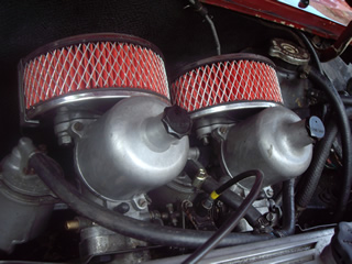

Hi all,
I have been looking at pictures of fellow ausmini member's engines n it seems as if the su's on some of them just look tiny? (might just be my eyes deceiving me :wink: ) i dont know what size mine are and would like to know how you can check the size of them?? i think they may be around 1 3/4"?? any help would be much appreciated.
cheers

Couple of easy ways to check , 1 1/4 had two stud holes (on the manifold side)vertically opposed , 1 1/2 had 2 stud holes diagonally opposed and 1 3/4 had 4 stud holes in a square pattern . The other way is to pop your air cleaner off and measure the throat .
PostPosted: Sun Jan 28, 2007 9:51 pm
Posts: 11264
They look like HS4's to me (1.5").
PostPosted: Sun Jan 28, 2007 10:00 pm
Joined: Mon Jan 08, 2007 12:03 pm
Posts: 179
Location: SCONE N.S.W 2337
Yep look like HS4 to me aswell
sounds like that one to me, and if others can tell jus by lookin at them, cant argue wit that :D thanks

so thats wat a HS4 is.... :oops: cant keep up wit the technical names lol
I'm also looking to get some K&N air filters to replace the ones in the pic above (look clean here but its an old pic) they are getting a lil grubby now and would rather a good quality filter like K&N, anyone have k&n filters that are like this???

K&N Filters on twin 1/34 look like this......
8) 8) 8) Prettyful!!!!!!! so how much did those cost approx??? sure have me convinced, airfilters wont hit the firewall with that shape either...did you have to modify anything??

PostPosted: Mon Jan 29, 2007 6:38 pm
Posts: 2645
Not a cheap exercise-but I'm a sucker when it comes to twin SU's.I really like the look of them 8)
First of all,I swapped a weber set-up for the twin carbies(that saved heaps)
Filters cost $128.00 each.
Inlet manifold(from Maniflow UK) $295.00.
Plenty of clearance on the firewall.
