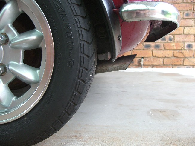

Hey all,
I am needing to extend my exhaust tip to be longer so as the fumes go out the back and not bacn into the car, also creating lots of soot on the rear bumper over time. What should i do???
cheers
>Rude<
this is after cleaning the soot off the back and bumper....
1992 Toyota Starlet GT EP82

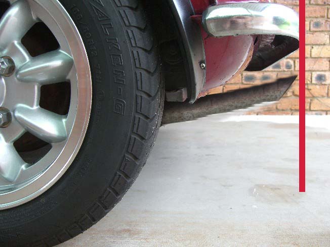

PostPosted: Fri Feb 02, 2007 12:59 pm
Posts: 501
Location: Nthside Brisbane
something like this, excuse to dodgeyness of it lol
or is that a lil too far out??
PostPosted: Fri Feb 02, 2007 1:09 pm
Posts: 11749
Your exhaust is ejecting straight into an area of low pressure, so its being sucked up. So either face the tip downwards or extend it past the curve in the back of the body,
