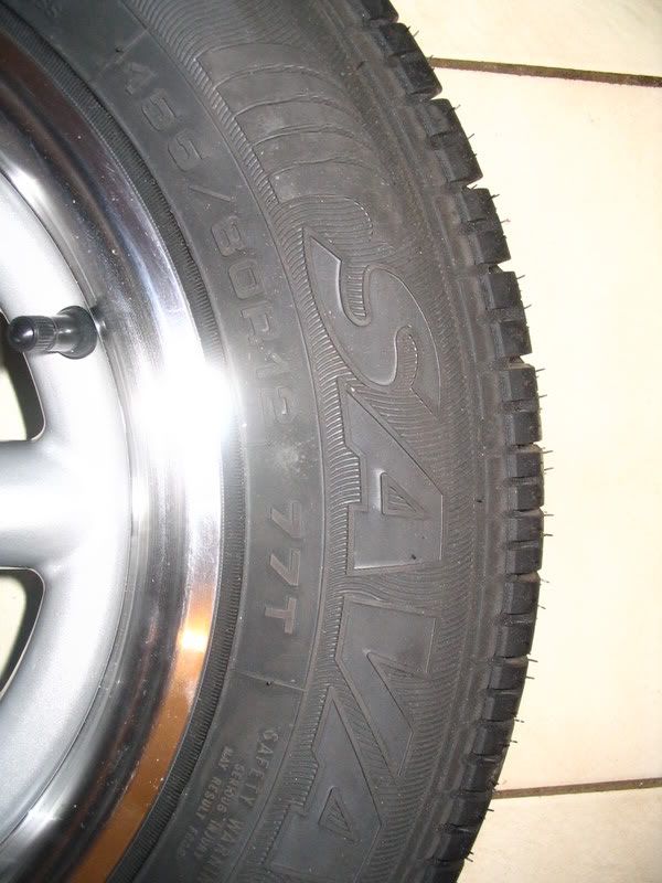

ok the tyre size is 155/80r12 ive called all round here and they all tell me the same crap that thats the onlky tyre i can get.i must admit that most of the tyres well the the whole 2 tyre shops in this town are pretty rude a##holes here.put here is a pic of the tyres they fitted for me and where its fowling.if anyone wants the tyres on the rims they can pm me as i have no need for them are are 100%brand new and never touched the road.
Image[/img]
PostPosted: Sat Feb 17, 2007 6:23 pm
Posts: 3635
Location: Gulgong
I think I know what your problem is.
They are fouling on the swing arm on the inside, right ?????
You have the wrong offset mag wheels for a skinny rear drum brake.
Now, all is not lost. Get a set of stepped Leyland S drums (and the wheel studs that come with them) or Cooper S drums and fit them. They will give you almost an inch of clearance and a wider track. You can get them off here, or off ebay or off a wrecker. Try Doogie.
Its probably that the wheel manufacturer assumed that all minis had the wider track drums and discs.
With the wider track you can also get the more common 165 x 12 tyres.

I don't think anyone uses 80 profile 12" tyres on mini's for the reason you have found , as BrickNut said , check the outside diameter of the tyre and if it's bigger than 500mm then it's not going to fit and you'll need to get lower profile tyres .
