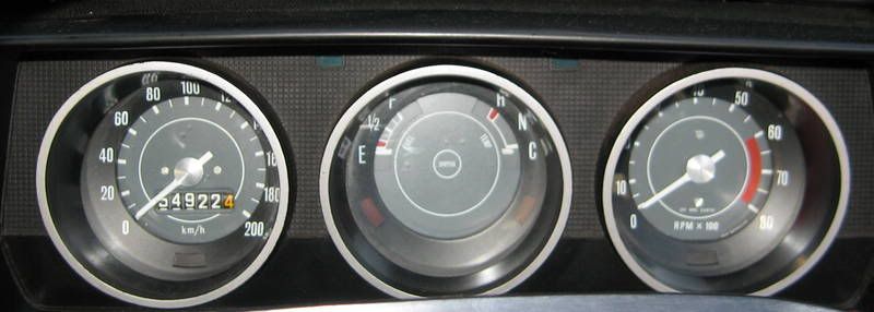

I'm a bit of a novice when it comes to "the dark side" :lol:
But the Clubbies are starting to grow on me! :oops:
Saw one at the weekend with a three dial dash, speedo went to 200Kph and tach was 6000 redline?
What would that dash set up be from? :?
Also, when did the Hydro on Clubbies stop? 71 to 73? 8)

Here's a pic.......
Anyone?

Graham,
The dash's from a Clubman S have a 5500 redline and I think a 160kmh top speed. I think that dash is from an LS or a GT(not 100%). My '73 clubbie had hydro, not sure when they stopped.

Thanks Steve, that's the reason for my question, I knew standard S's etc were 5500, but I thought GT's were 6500?
Mystery, maybe LS? Wheres Chris Czerial? :lol:

Thats a late pommie 1275GT dash right there.
Probably from an NZ spec car.

Hmm? maybe got converted to Kmh for NZ? Uk would have been MPH obviously.
200Kmh is 125 Mph!! :shock:

A 1275LS dash goes up to 160kph and has a 5500rpm red-line. It also has two extra warning lights in the top corners of the surround.

yup 100% correct from everyone! 1275 GT dash ( i learned that from the GT professor)

whats the light ontop of the middle guage? directly above the smiths logo?

You mean in between the fuel and the water ?? there is no light there actually - just an illusion in this case.

My 998 LS Clubman tacho goes to 8000rmp and the speedo to 160kph..

Yeah it's redlined at 5500rpm though, ay?
My 1275 LS guages are 160kph and the tacho has redline at 5500.

The Marina used the same gauges and went to 200kph (who knows why). When I changed diffs from a 3.44 to a 2.9 I swapped the 200kph Marina faceplate onto the existing Mini gauge which then gave nearly the correct speed. The Marinas had three gauge clusters, but mostly had a clock instead of a tacho. I can't remember what the redline on the Marina tacho was.

Sally has the same as Smokie, she redlines at 5500rpm :D
