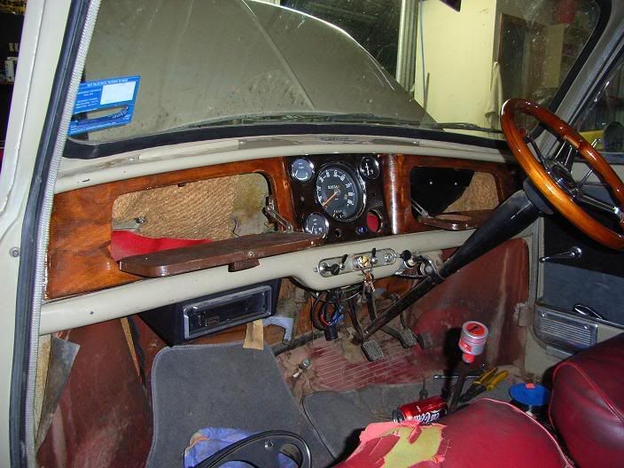

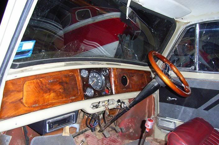

Yes my woodgrain is missing the wooden strips at the end, however they can be made easy enough hopefully.
Here are a couple of pics of the woodgrain. Second is when it was first put in and the first is how it is now. All I have to do is put a tacho in and the indicator lights etc, the hole on the drivers side I have made a bracket to sit my Garmin GPS in. I have a spare right hand side anyway if it doesn't work out. Now the woodgrain is in, seats will be this weekend.
