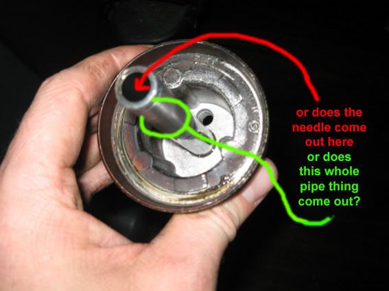

ok before i started attacking this thing again i just wanted to make sure im gunna push/pull the right thing out the right way.
ill let the pictures do the talking
does the nedle come out...
if it does go that way,....
or just the brass needle bit
OR.........
sorry for all the questions :)

Location: GerMini
His way, yes
The whole "darker thing".
It keeps/holds the needle in position and comes out with the needle.
Like this: The thing that looks a bit like a hat is the upperside of the needle.
OR.........
Here`s only the damper-oil :)
No worries! :)
