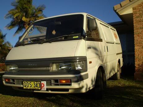

Well at the moment I am stuck with this to drive...
