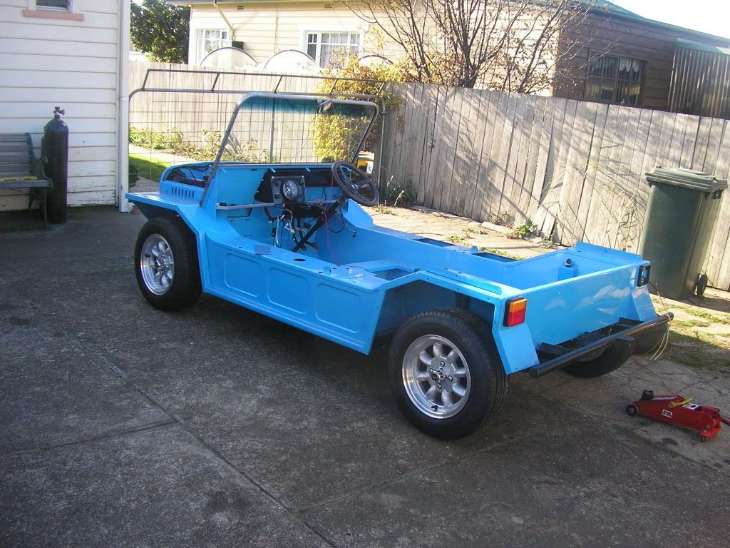

this is the car, those are the wheels. i have tried pulling the wheel and turning the nut, no luck.

What ever you do I can see you'll want to do it carefully. Nice lookng set of wheels.
Dicko.

lol im taking the wheels off, i hate them. im putting a set of stock rims on. (and welding the front gaurds back)
ill put the wheels aside for a project, later in life.

Those big wheels (would) look good, Josh. On a Moke.... :lol: 8)

lol i know, i didnt buy em :P

i think they look good on a moke as well

Looking good Al, what size tyres?? :P
PostPosted: Sat Jul 07, 2007 9:49 am
Posts: 2434
Location: tasmania
tyre size is 185 x 65 x 13 on 13 x 6 rims
