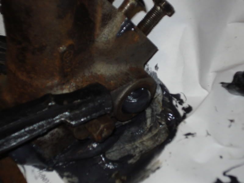

PostPosted: Mon Aug 13, 2007 10:15 pm
Posts: 18888
I had a brain wave tonight, strong enough to make a small globe glow dimly.
I stuffed the master cylinder with grease, and jimmied a grease nipple onto the end of a grease gun. I'm not sure how many PSI a grease gun can provide but figure it would be one metric shitload.
So away I pump, pump, pumpitty, pump, pump, pump..... and all seems to go swimmingly with heaps of pressure, but still no go. The paper gasket on the bottom is letting me down at the moment. I've got to figure a better way....
i can get a portapac I am sure from coates or similar, but how can I get it to pressurise this thing to push the air valve piston out?
Don't hassle me about the bench either, there's four mini related projects going on concurrently (two pairs of SU's being reconditioned, the booster and pulling down the Cooper shell )
