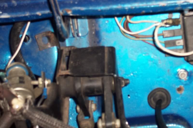

Here is my an attempt to mount a rover brake master to my 1971 round nose.
I've modified the little plate that the old cylinders mounted to (and engine steady) and also the bit that the bonnet arm sits in.
I'm wondering if anybody has pictures of how much to chop away so that the bonnet arm
can sit in the booster bracket.
(images are clickable)

you would also want to modify the bolt(and bracket) going through the firewall...
turn it around 180 degrees, otherwise your bonnet will never shut properly.

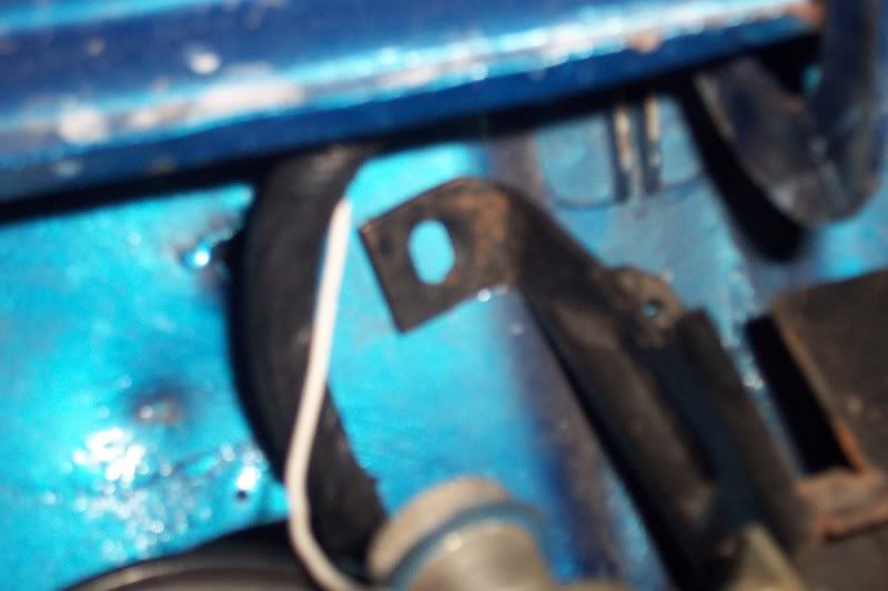

Thats what i was asking about what modification needs to be done to the booster bracket, because it looks like i almost have to cut threw the whole thing, to allow for the bonnet to shut.
do you have pictures??

i put a slit straight through the bracket 10mm wide.
main bolt still holds it all together fine

Indeed they are, i believe they are in the same place as clubmen bonnet hinges. However the booster bracket (the bit in black in my picture) can be modified to suit.

Instead of modifying the rover brake booster bracket i decided to make a new bonnet arm which clears the brake booster bracket. It still needs a little cleaning up.
(Images are clickable)
