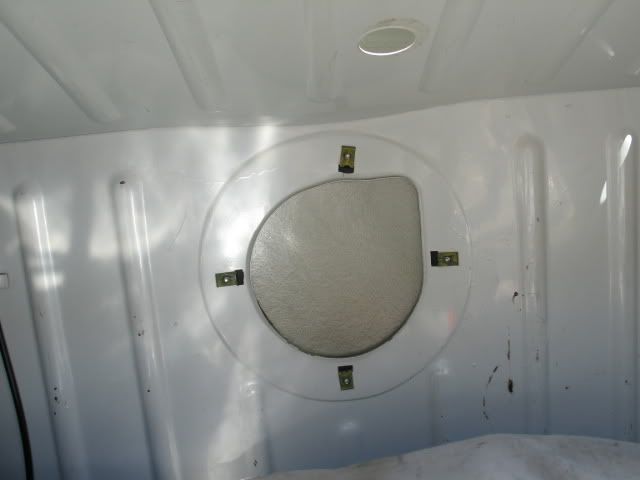

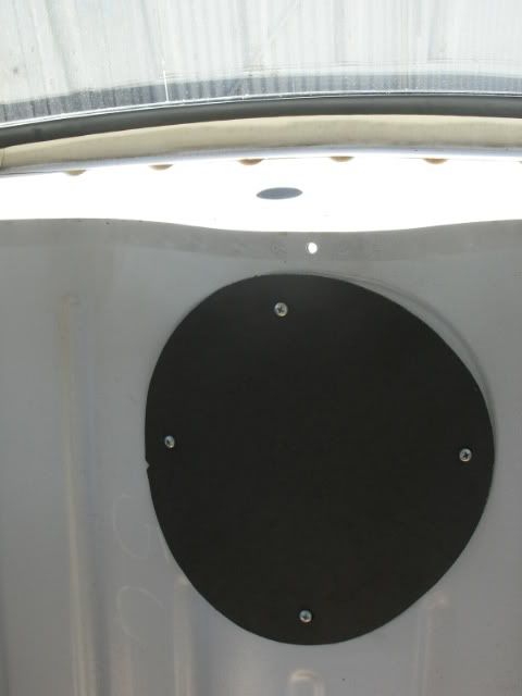

Imagehttp://i187.photobucket.com/albums/x34/Mort_Subite_2007/today_20070917_0001_1.jpg?t=1189994137http://i187.photobucket.com/albums/x34/Mort_Subite_2007/today_20070917_0002_1.jpg?t=1189994205

Used when the body shells were rotor-dipped.
A blardy big pole went through the guts of the shell, and it was dipped completely in a tank of primer / anti-rust solution. It was also spun 360 degrees on the pole, so the solution covered every surface.

Jeepers :shock: Ah ok of course - rigid frame/stressed panel construction technique.
Thanks - I wont touch the cardboard and vinyl cover then. There wasnt some amazing rear boot heater for cool climates. :lol:
