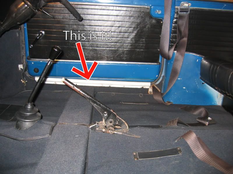

Does anyone know what the original carpet sill on the door looks like.
Mine has more holes in it than swiss cheese and i dont even know if its original?
cheers
PostPosted: Mon Sep 10, 2007 10:36 pm
It should have a texture/ pattern made up of small triangles. The front and rear end should both be square. It looks like someone has trimmed yours up at the leading edge.
Easily found however on other later minis.
PostPosted: Mon Sep 10, 2007 10:37 pm
Posts: 3747
Location: Altona, Melbourne
Nice one Mick! Will try find some.
Installed the carpet tonight, fitted like a glove. well happy with it. :D :D

You didn't find those carpet clips at Woolies by any chance did you??
PostPosted: Mon Sep 10, 2007 11:07 pm
Posts: 3747
original ones mate, need to get the bottom ones that are screwed into the floor. Have got some of those carpet clips here i got in the Uk, didnt come with the other part i found out now :oops:
PostPosted: Mon Sep 10, 2007 11:12 pm
I've got those parts I think you are missing (the floor half of the clips right??), however they are the shorter type used on most minis. the coopers had a taller type to suit the carpet and hessian underlay.
I can help you with the shorter ones if you need them, they work fine (I used them on the old cooper). You may or may not choose to make a spacer to make them a little taller. No real visable difference once they're pinned down anyway.
I've got the tall ones that came out of my car, but will reuse them.

Old clip (with plastic spacer to allow the hessian underlay)...and new clip from Woolies in the UK. About 30 cents each I think. The new one could defintely de adapted to replace the old.
The old one (although covered in paint) seems to be plated brass.

could you tell me where to get that type of carpet in the pic ?
PostPosted: Thu Sep 27, 2007 12:10 pm
Someone sold it on eBay and he picked it up.. NLA anywhere new afaik.. :)
PostPosted: Thu Sep 27, 2007 12:23 pm
Nope, can be found.
It's called Tretford now, and is distributed by the gibbon group up in Brisbane.
It's still made from a majority percentage of goat hair, and is a fraction thicker due to a thin pvc rubber backing. It's an industrial architectural carpet generally.
