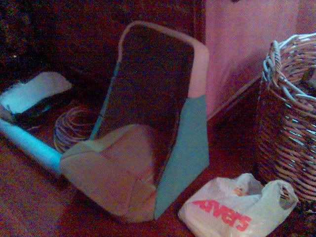

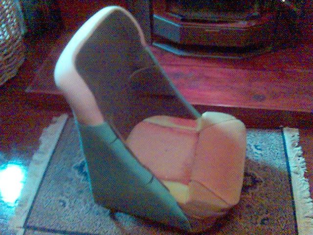

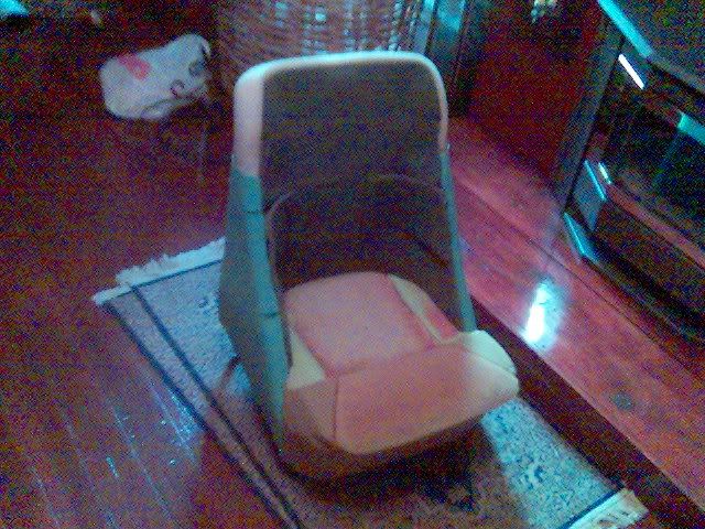

PostPosted: Sat Oct 13, 2007 1:24 am
Posts: 1581
Location: melbourne
yeah i did it a while ago, looks ace and great support. much better then cobra classics. sports 850 is the new owner of the seat (and car)
from this
to this

Posts: 544
there we go, thanks 1970miniK thats great. So just bars that og down on the side what about lowering, is the seating area still the same height? did u remove the rubber on the bottomor change that?
PostPosted: Sat Oct 13, 2007 2:41 pm
Posts: 1581
Location: melbourne
yep bars down the sides and galvanised sheet metal filling in the new sections (cobra are hollow)
i removed a bit of the base foam to give a deeper feel, not much though. i've had guys plently bigger then me in it and they said it was great too.
heaps of hip level support, not much more then standard on shoulders

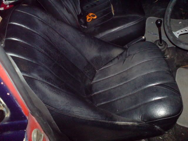

PostPosted: Sat Oct 13, 2007 3:55 pm
Posts: 4031
That seat looks great. But I have to ask, besides looking all period 60s racing style, what is the point?
I have normal, but very comfy seats in my Mini, and when thrown around corners the passengers sometime go flying (although generally I drive alone anyways.) but the driver, me, doesn't have a problem. A good tight seat belt and a good grip on the steering wheel provides plenty of support.
My dad's Mini has Suzuki Swift (I think) slightly bucketed seats (modern sports seats) and besides looking out of place in a 70s car, makes no different at all, and the seats aren't as comfy as my seats.... Advantage..? Nil.
