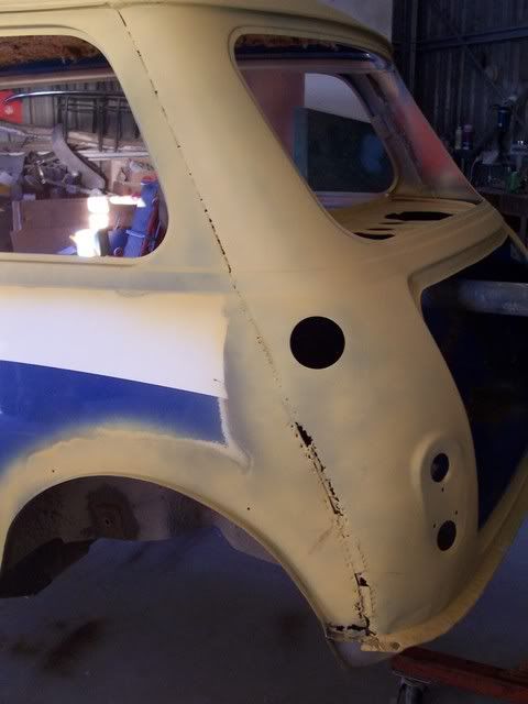

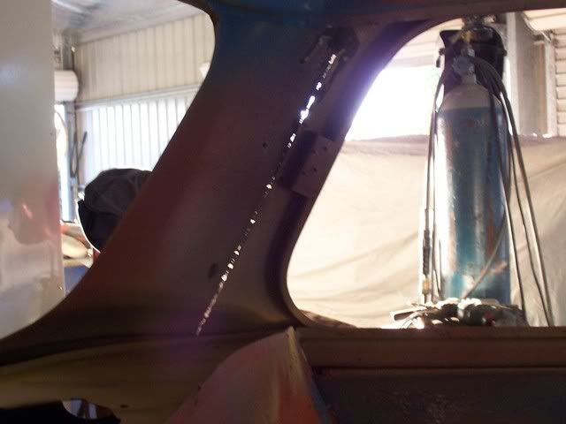

PostPosted: Sun Jun 08, 2008 9:28 pm
Be careful this is what a "panel beater" did to my car and I only found out 2 years after it was done :x :oops:
VERY UNSAFE
They are now fully welded and now a lot safer/stronger :D
The best way I would do it would be to fully weld the inside of the seam, then weld an inch wide strip of steel down the length of the seam on the inside, then cut/grind an inch or two off the external seam and weld it back up and then another inch or two and weld and so on until it's fully welded.
A lot of work and technically/legally it would need to be engineered and mod plated aswell :roll:
whats going on there mate? is that how much he welded ? and filled the holes in with bog?

yep that's what the old panel beater did, just spot welds and bog :evil: I never saw it until I took the car off the road and sandblasted it :x . the new beater has now fully welded it all up.
Fark - that is just downright dangerous!!! Holy smoke Kenno, if you had had an accident in that it would have folded like a Coke can. You are very lucky my friend! 8)
