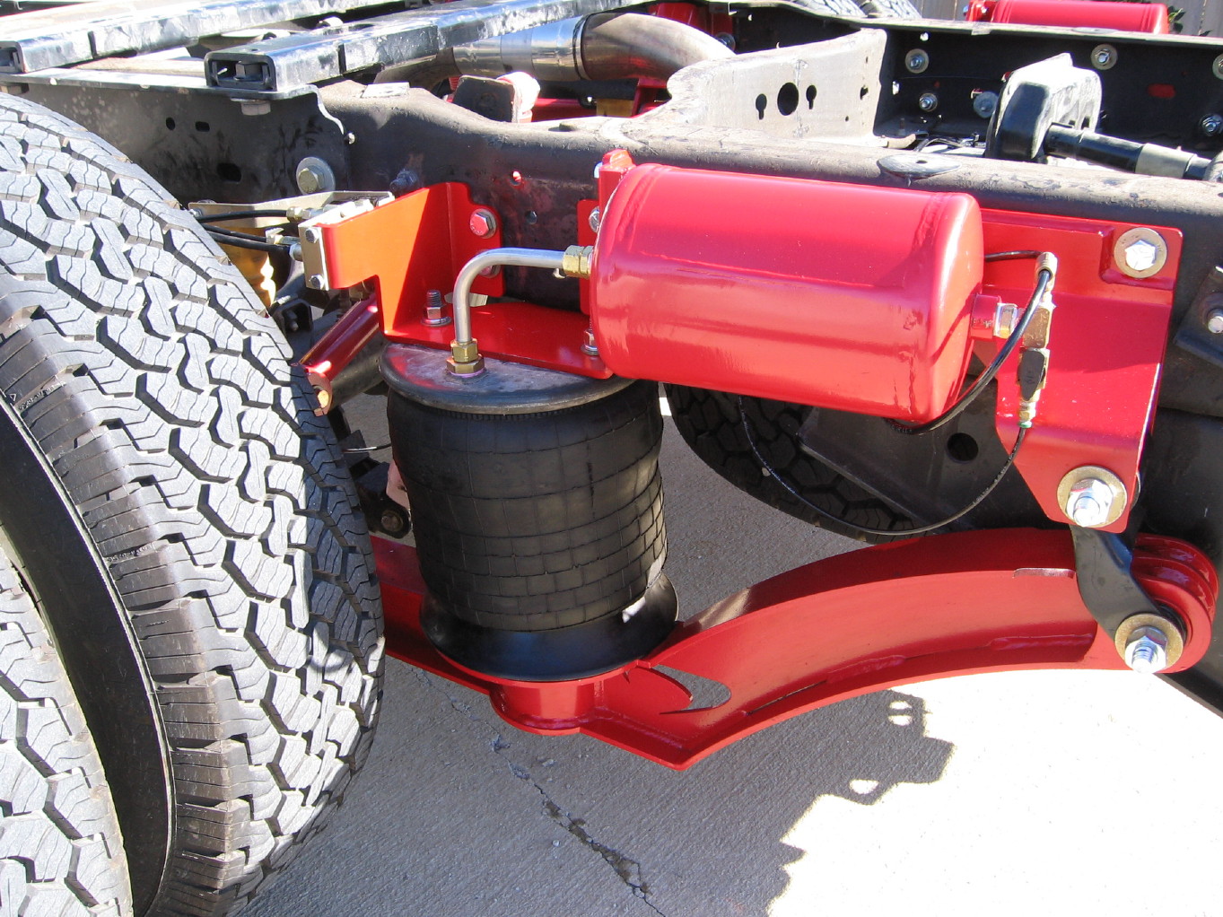

mostly after a good ride HEIGHT i cheked out gordos cconversion he is using hydrulics isnt he? not sure on how much pressure they run i think it depends on the weight of the car and the amount of convolutes in the bag id say you would only need a single convoluting bag, but than again when the bag is deflated it could rub against the sides of the frame
http://www.stengelbros.com/photogallery/IMG_0314_1.JPG

Im not going to run any bags, im still using the rubber cone ( well not exactly, as i have a spring replacement) but using a hydraulic ram instead of the metal trumpets... Dont know what sort of pressure im going to be running yet as like you said it depends on loads and stuff like that, but the pumps i have will be able to lift just about anything...
Air bags are too big, and the air trumpet things they also have a re way too long, it could be done but a whole new suspension setup would have to be designed and harldy worth the effort
