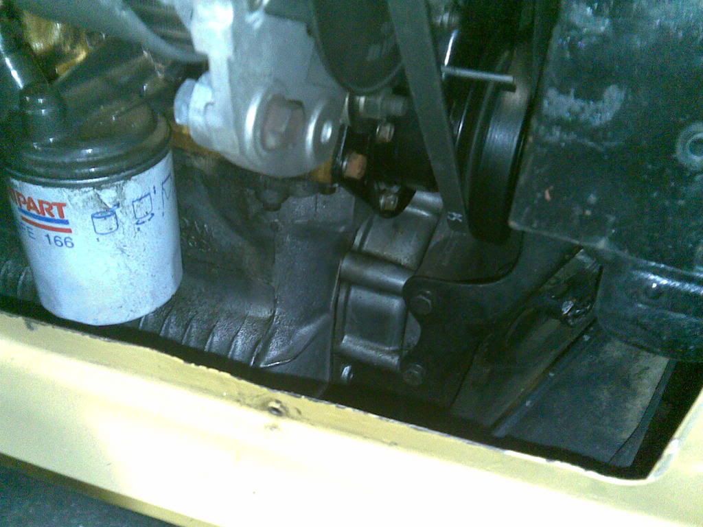

heyy thier i have a mini innocentii
i try installing a 10 row oil cooler but i cant seem to find a place where it will fitt
pictures would help alot
i have put some pics up to show u how the engine bay looks like
thankz

min196 wrote:
the standard spot for a Cooper S is right in the centre of this photo, cut where I've marked in red, and fold it back, drill a couple of holes and mount the cooler there. You'll need some re-inforcing to stop it flexing - standard S again was a pair of brackets that went from the lower lip of the beaver panel up and they had a 90* bend in them that went under that lip. The bent part was longer than the lip, and had another screw hole in it that lines up with the rear mounting holes in the cooler
you'll probably need to space out the grille to keep it from rubbing on the cooler

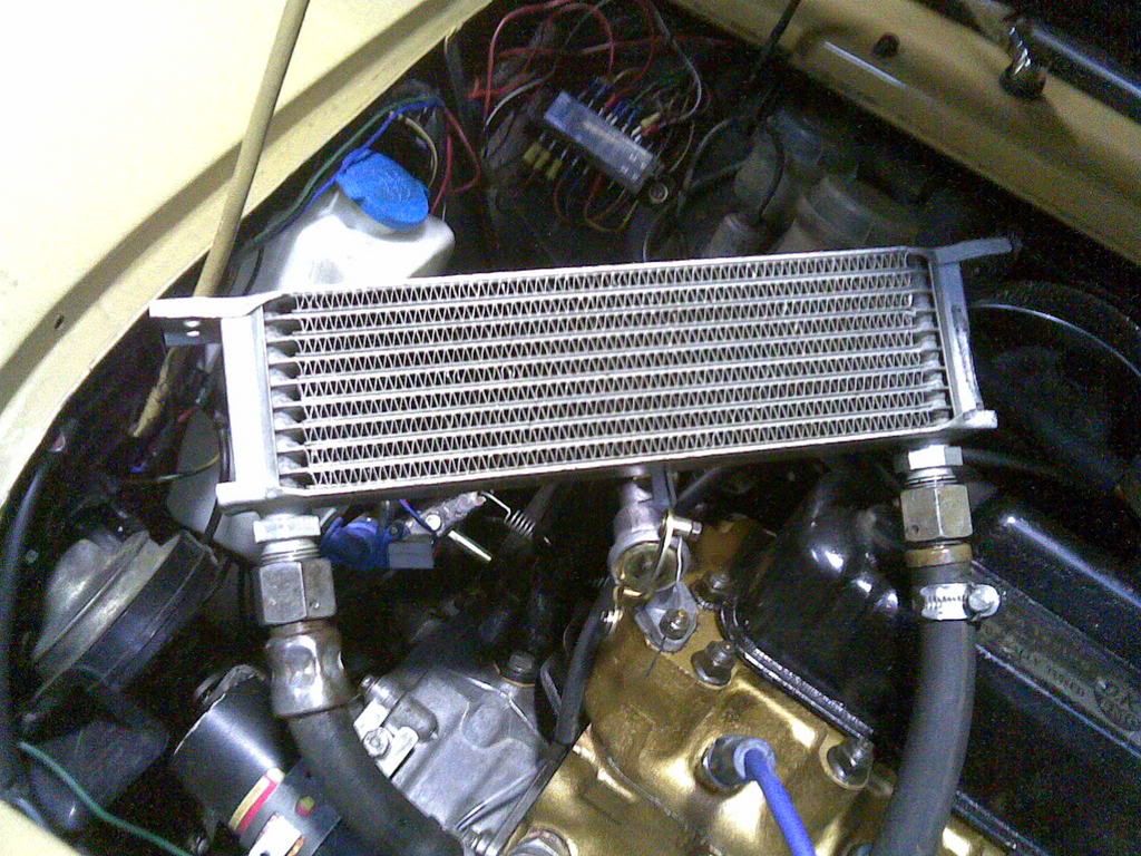

Here's a few pics of the oil cooler on my S if it helps at all. The top shot might help you with hose placement.
http://img231.imageshack.us/img231/3339/mini1mj0.jpg
http://img150.imageshack.us/img150/9607/mini2ru6.jpg
http://img232.imageshack.us/img232/8819/mini3aw7.jpg
