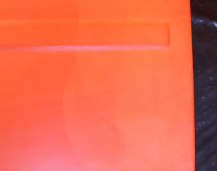

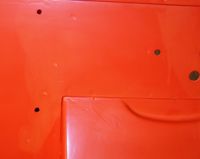

I finshed the colour over a week ago.
Just went and cleaned it down about to put some clear on and now some parts look like this...
Looks like there are water marks in the paint and its discoloured. How can I get this out before I clear it?
Or will I have to paint colour over it again?
I have no idea what has happened, all I did was wash it with wax and grease remover.
Rogg!!!!!
nasty.....
wax and grease remover is a type of thinners/prepsol isn't it?
if so, it's dissolved your paint....
